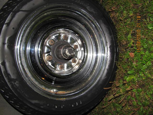

Hello everyone. We have a question for you. What are these rims from? The wheels are 15 inch Tires say F 65 15 St Are these somthing special or Special Trailer Tires Maybe?? We dont have such marked here nor are the 6 bolt easily found..Spcialty tires yes for caravans but not with the ST marked on it.
I should mention these came with our 47 Kit. & I highly doubt these are original. Had them inspected and these tires are unsafe due to them having cracks, and split with some rot found on them. So we need new tires ;)

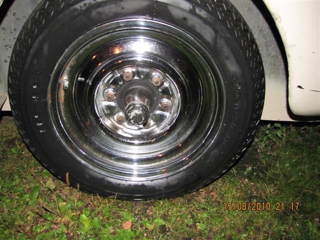

Here is a photo of 1 of the 2 Kits in our yard.. there you cans see the hubcaps that came with it.. Genuine Chinese Chrome.. :lol:

Now the axle center sticks out about 3.5 inches from the rim.. What are my alternatives for rims and what can I do to find suitable hub caps. Tried baby moons but due to the center sticking out so far I came upon Coker Tire Hub Caps which are called (Bullet Cap Short) 3 1/2 inches.. it will fit but sure does look tacky. And it doesnt suite my taste.
Pic to assist with our question.

Heikki, an F65-15 would convert to the metric equivilent of a 215/65/R15 tire. Fairly tall and narrow by todays standards but very retro looking. Can you get a measurement on the lug pattern on the wheels? 6 hole wheels are fairly common here on light duty pickups. Nissan and Toyota used to use them too, not sure on the newer stuff. Should offer some selection at least (if not low prices)
about mid way down the page in the link is a section with a conversion tool for tire sizes. Hope that helps a little.
http://www.carbibles.com/tyre_bible.html

Greetings Shaun and Thank Kindly for your reply. I,ll get that measurement for you.. Also would you have an idea as to what kind of a hubacap could be used instead of the ones that are on it now? Or how can a baby moon or somthing nicer be fitted to this hub or is it so that it cant be at all?
Im not so good with this tire stuff :oops: :lol:

Boy, I don't know about hubcaps. Those hubs are really tall compared to most aren't they? Have to ponder that some. Maybe if an aftermarket wheel can be found it may offer some solution. The only thing that comes to mind off the top is maybe something for 4 wheel drives, as they often had longer front hubs too. The full covers like the one in the pic above looks good too.
Did Kits come with hubcaps originally? Seems like many in the pics I see don't have them, maybe thats why... :thinking:

Maybe some chrome lugnuts and cleaning up of the grease cap would help..but then again it may not be good if the grease fitting is out in the open??
The seals and such are sure greased up. So that is no issue at all. We checked them recently. :thumbsup:

Chrome lugnuts, beauty rings and spinners for the grease caps 8)
or something like this...
lots of options from this outfit;
http://hubcapmike.com/vintage_hubcaps.html

Do you suppose that hubcap would fit? I like that much better already :lol:
I am a smoothie or baby moon hubcap fan,,Ive always liked them..

Searching I came up with these. If my memory serves me right Doug Hodder has wheels from this company..I could be wrong though but these I like. Now if only they would fit.
http://wheelvintiques.myshopify.com/pro ... -12-series
or http://www.wheelvintiques.com/index.php ... artillery/
Have to check the offset 1st. And to see what type of hubcap would fit :thinking:

Finn...I have a similar set up on the Voyager but on 5 bolt 15" wheels. You need to get the diameter between the cap nubs on the center of the wheel, and match the bolt pattern to a manufacturer...I'm thinking it's a Chevy...you got a 46 PU...compare to the ones you have, see if it will bolt up. Chances are...it's something that is readily available. My center hub sticks out 3" but the depth of the cap is 3" also and it sits out on the wheel center, not flush with the bottom of the center. There is probably more than enough room to fit it on yours.
These are smooth stainless caps, they also have the stainless trim rings. Here's the link...go to accessories then find the moons. I'd drop them a note and use my pics if needed to get what you want, once you find the size. www.thewheelsmith.net
Doug
Here's a pic of the back side of the cap. The inner lip hooks up with the nubs on the inner portion of the wheel hub.
Side view of the cap, showing the attachment ring.
