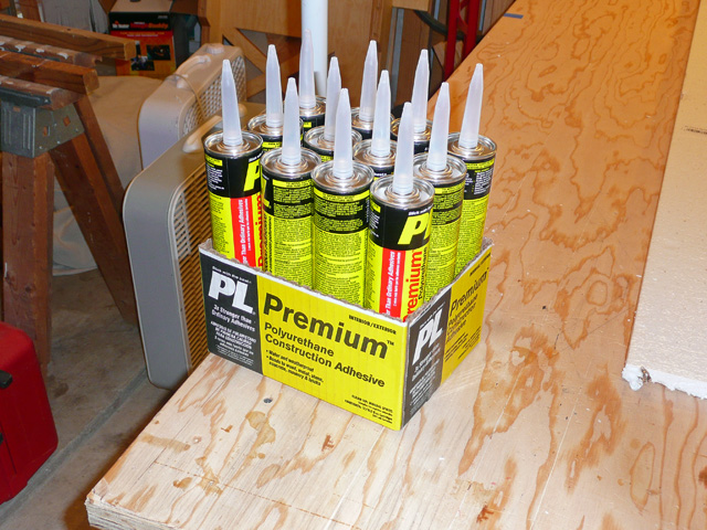

Postby aggie79 » Fri Aug 20, 2010 8:53 am
Aint2Proud wrote:I have PL Premium and used it to attach the outside skin. That was the first time I used it and even with weight on the wall the skin came out wavy because of the expansion.
Ryan
Ryan,
Please excuse this question. Did you use polyurethane (PL) glue - "Gorilla glue" - or did you use PL Premium?
The reason I ask is that PL glues do foam when they cure.
I used PL Premium to attach my sidewalls to the floor and bulkheads and to attach the plywood skins.
The bulkeads fit into dados and the floor fits into a rabbet. After I applied the PL Premium, I did use screws to fasten through the sidewalls into the bulkheads and the floor.
On the plywood skins, a j-roller was used to "spread " the beads of adhesive and screws were used as temporary fasteners.
I may have been lucky, but I didn't see any expansion of the PL Premium or waviness in the plywood skins.

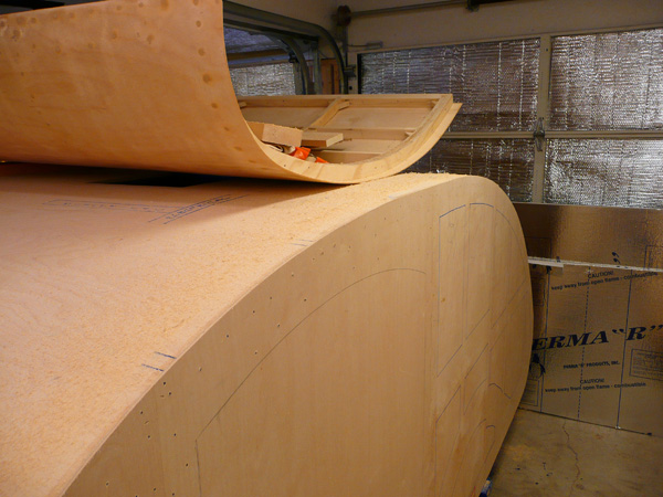

Postby aggie79 » Fri Aug 20, 2010 3:39 pm
Aint2Proud wrote:I am new to all of this so ask away!
In response - I did use the PL Premium, not Gorilla Glue. You got me thinking that maybe I just used a bit too much on my framing or the weight was not centered directly over the framing (or both). My wall skins are 1/8 inch thick so they are probably more susceptible (sp?) to deforming. If PL doesn't expand like I originally thought then I will use that. Thanks!
Ryan
Ryan,
The PL Premium is pretty thick (is the better term "viscous"?) stuff. It won't lay down flat without persuasion.
From this board, I've learned that there are several approaches to getting it to work. On flat areas, a notched trowel like what is used for vinyl flooring can be used to spread it out. (This stuff is hard to clean too, so you the disposable plastic notched trowels are probably better than the metal ones.)
For my exterior 1/8" sidewall plywood I just squeezed out the beads of PL Premium on the framing, applied the plywood, and then rolled it out using a j-roller to squish it down.
As far as the sidewalls to bulkhead and floor, I put these together before I applied the outside plywood. The screws I used to fasten everything together before the PL Premium set were enough clamping pressure.
If you haven't applied your aluminum, you could also use screws, either permanent or temporay, to hold everything together while the PL Premium set.

Postby S. Heisley » Sat Aug 21, 2010 7:24 pm
It depends on the kind of PL Premium glue:
PL Premium Polyurethane Construction Adhesive or the kind like Aggie79 shows does not expand as much as some.
PL Premium Polyurethane Wood Glue expands a lot and then oozes out. That one has a short shelf life after opening, too.
