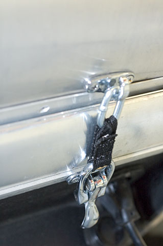

This set-up worked to allow for locking of the hatch, but it did not apply enough force to fully seat the weatherstripping. Therefore, we added some overcenter latches to the bottom corners of the hatch lid to pull the hatch tight.
These chrome beauties were purchased from West Marine http://www.westmarine.com, the link is from a piece of chain and the webbing was sewn to get the exact length (by trial and error) we needed for proper function.
I hope this helps.
