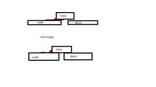

Postby Aaron Coffee » Sun Aug 22, 2010 8:32 am
here is a crude illustration the trim will be affixed to the door, the red is the hinge
These where my 2 thoughts on using a paino hinge and with each the trim will hit the hinge at around 90 degrees or less.

Aaron Coffee wrote:here is a crude illustration the trim will be affixed to the door, the red is the hinge
right! I see your problem now.. let me check some catalogues and I'll get back to you...

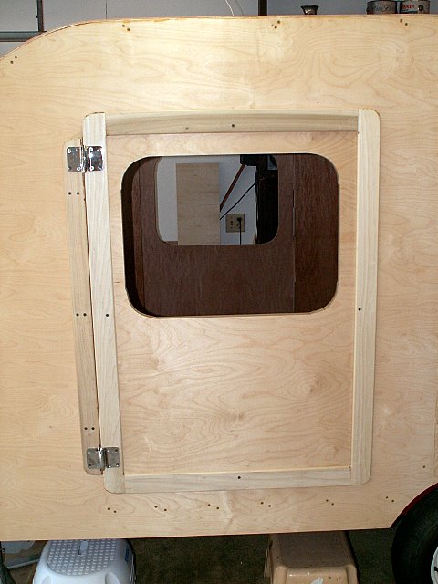

Postby Toytaco2 » Sun Aug 22, 2010 4:25 pm
Ok, here's another option for you. I trimmed my doors with 1/2 inch poplar and used "torpedo" hinges. An added benefit is that the doors can be lifted off if you want to remove them.
