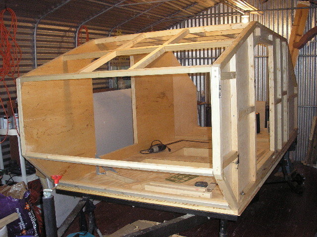

Postby GeoDrop » Sat Sep 04, 2010 7:57 pm
I made a choice... and some progress. I chose to use 1x2's and rotate them so the roof thickness is 1.5". Thanks to CaseyDog for showing a picture of his. Here is a picture of mine
