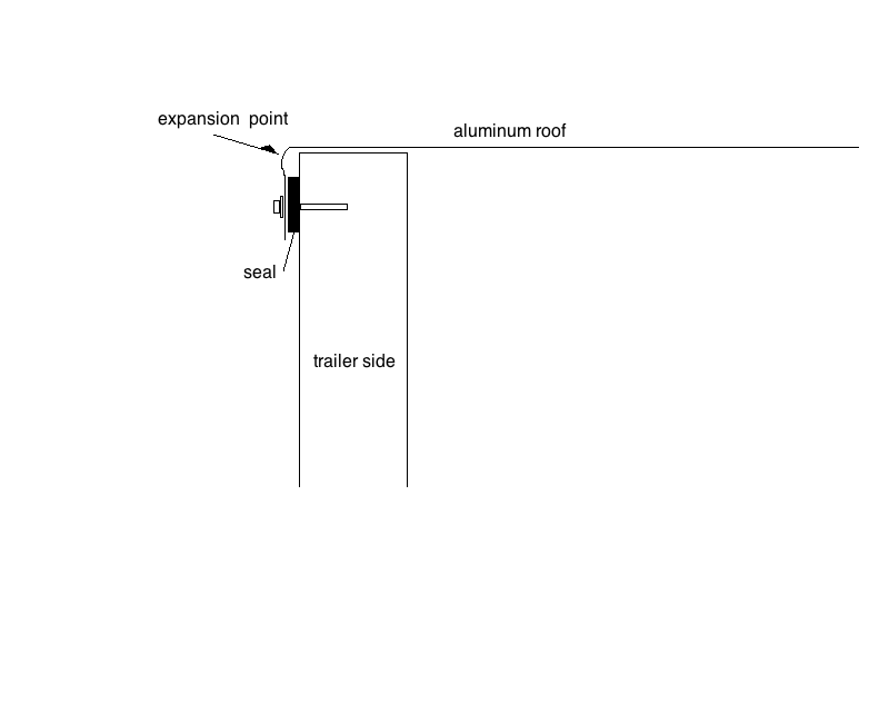

alffink wrote:There is really no reason to use screws or adhesives to tie the aluminum directly to your roof, with or without a plywood underlayment.
Let it float, using the edge trim and the vent flange as the securing points
Either way you decide to go, really pay attention to your sealing of the edging, I have found that the aluminum's shrinkage - exspansion rate is more than I expected and I have worked as a tool/modle maker for nearly 30 years...this temperature induced movement has broken my silicon beads under my trim in some areas, not good when it rains or just washing the rig for a new trip....water has a tendency to wick, where ever it can find a path, usually right into the side walls.
madjack wrote:...here's what I do...first I cut the AL 1/4" narrower than the width...this allows a little "wiggle" room while fitting, along with a little expansion room...I use no underlayment(no ply) and lay the AL directly on the ribs...I basically float the AL on top with no adhesive...I do use a couple (or three) of air driven staples(per side) to help hold the AL in place until the trim can be put in place to hold it permanently...I used urethane windshield sealant on the first and regular RV putty tape on the second...they both worked just fine but prefer the putty tape for ease of use...and that is how I doit...by the way, I developed this method after several conversations with the fine folks at Camp-Inn, it is the basic technique they use..........
Larry C wrote:I see you used 3m 4200 for your trim seal. This is an adhesive type caulk. I assume your trim is permanent? I doubt you could remove it without damaging it or the skins.
After my experience with 3M 5200 failing quickly, I am wondering if this type of harder setting sealants are not the best choice for something that is expanding/contracting so much.
It would interesting to hear from others on this subject: permanent vs removable trim sealant.
