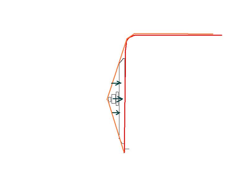

Postby bobhenry » Mon Sep 20, 2010 12:31 pm
I used 4 1/1/2" heavy duty ratchet straps.
If you place scrap foam under the strap it will protect the face and equalize the pressure.
On vertical surfaces like your front use a strongback with a standoff
( a good straight 4x4 with a large block of 3-4 2x4's stacked in the middle) this will create lateral pressure to the vertical face otherwise it would simply pull straight down.

Postby bobhenry » Mon Sep 20, 2010 1:27 pm
Here is a poor rendition of what I was trying to say.
(Paint sucks wish I was a cads guy)
The orange is the strap the red is the profile. Maybe this will help a bit
Postby tcolar » Mon Sep 20, 2010 1:36 pm
Yep, I understand that, thanks.

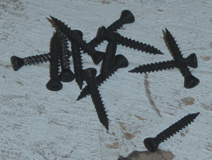

Postby schaney » Mon Sep 20, 2010 2:52 pm
Tcolar, I'm a fan of using trim head screws where clamping isn't easy. I leave them in for some added strength. I use the excess epoxy from gluing to fill the holes, so far, haven't had any back out on me.
Scott

Postby aggie79 » Mon Sep 20, 2010 4:38 pm
schaney wrote:Tcolar, I'm a fan of using trim head screws where clamping isn't easy. I leave them in for some added strength. I use the excess epoxy from gluing to fill the holes, so far, haven't had any back out on me.
I used screws (self drilling) too, but with PL Premium instead of epoxy as an adhesive. After the PL Premium set, I removed the screws and filled the holes. Then a single coat of epoxy was applied as a seal coat before the aluminum was installed.
It took quite alot of time to fasten everything, but the PL Premium had a long working time. You may want to consider how much working time you'll have with the epoxy.
Postby tcolar » Mon Sep 20, 2010 4:44 pm
Yeah, I think I will go with the screw method ... makes sense and is a pretty flexible & simple method.
With the epoxy i have and the medium hardener and temps around 60F here, I should have quite a lot of working time, at least 2 hours.
