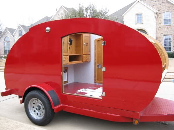

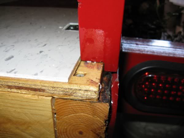

Postby planovet » Wed Sep 29, 2010 4:19 pm
Maybe this will help:
ImageMark (& Cindi)
planovet
The Cat Man
Posts: 5583
Location: Plano, Texas

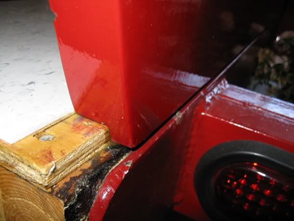

Postby planovet » Wed Sep 29, 2010 4:45 pm
My wall attachment was a "hybrid" because of the trailer I used. When I attached the walls, there was a small gap running along the entire length of the trailer. I used silicon caulk to fill the gap and then covered it with diamond plate to cover the gap and add a little protection. I hope it won't leak but we will find out someday.
