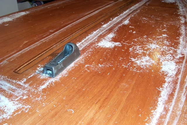

Postby rmclarke » Fri Oct 01, 2010 11:16 pm
Brian,
Ditto what Doug said.....I removed the tape edges on my trailer with a Stanley Surform tool (me and grinders have cause some serious damage in my time :oops: )...just let it cure well. Here's a pic from when I did my boat after I taped around the centerboard. The surform took the big edge down quickly, then I feathered it like Doug said with a sander....then I clothed the bottom.
With the trailer, I just taped the edges.....after I feathered the edge I applied another coat of epoxy to the whole trailer. The edges 'disappeared' quite nicely.
Are you planning on putting fiberglass cloth over the whole trailer?
Richard
"When a hammer is the only tool you own, every problem begins to look like a nail..."
ImageFrom this: Image to this: Image Finally!!
