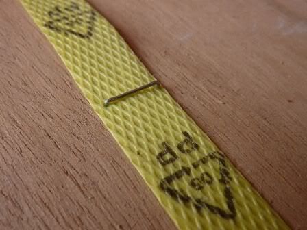

I can see that no fixings is likely to give the nicest finish, but if you want to use staples, here is a variation of the trick used by guys who cold-moulded wooden boats (for whom 1000 staples was a few) - fire the staples through old polypropylene packaging tape:
The tape is strong enough that the staple doesn't leave an indentation plus if you're lucky, just pulling on the tape will get the staples out. That's why the staples need to be put in cross-ways as shown - if you put them lengthways, the tape splits at the staple when you try to pull them out.
