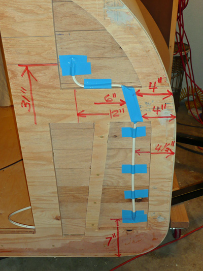

dmckruit wrote:^That should be fine. The only other thing you have to worry about is putting a screw through the wire when attaching your roof and ceiling. I ran one electrical outlet in the front of the cabin (the rest were in the back), and this was the only outlet that had the 110 wire running through the roof. When I connected the power and flipped the breaker, the ground fault outlet on the house kept tripping. I determined that a screw was through the wire. I had disconnected the suspect wire from the breaker box, and only this weekend I embarked to repair it. I had to remove the inside ceiling and replace the wire where it was punctured. It took me all weekend but its fixed.
