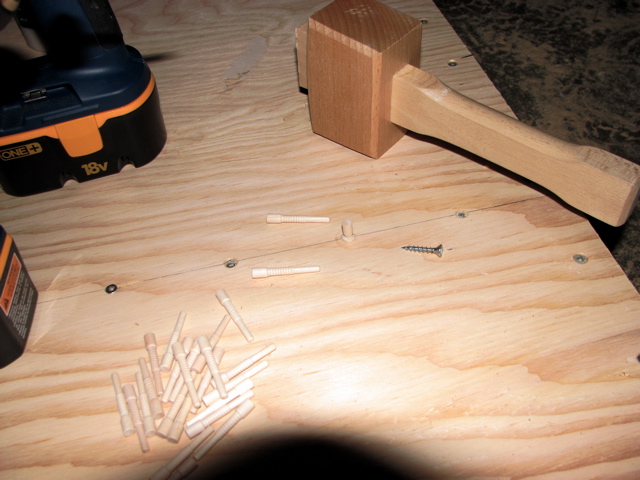

Trying to build with as few metal fasteners as possible. Used these Miller dowels for the floor, hope this works. Anyone have experience with these?
One problem I have is that the drill bit is so aggressive that it tears up the plys of the plywood, is there a way to solve this? Thank you in advance for any help, I have never built ANYTHING out of wood before.

sdave209 wrote:One problem I have is that the drill bit is so aggressive that it tears up the plys of the plywood, is there a way to solve this? Thank you in advance for any help, I have never built ANYTHING out of wood before.
Have you tried a brad point drill bit?

Postby sdave209 » Sat Oct 30, 2010 11:31 am
The dowels use a special step drill. The drill is the same shape as the dowels which have 3 different diameters in each dowel. Ill post a link if I can figure that out.

Postby MikeW » Sat Oct 30, 2010 11:54 am
You could break through the first layer of veneer with a brad point or forstner bit and then drill the hole with the step drill. Another option might be to clamp a 1x2 over the ply and drill through that and into the plywood if your bit is long enough.

Postby sdave209 » Sat Oct 30, 2010 11:59 am
Yes, I like the Idea of breaking the first layer of ply with a brad point bit. Great idea. Thanks Guys.

Postby DIY-Stu » Sat Oct 30, 2010 12:00 pm
Use higher speed to cut the first layer and a light touch. But splintering is actually a good thing. Gives more surface area for the adhesive to grab onto.

Postby toypusher » Sat Oct 30, 2010 3:41 pm
Try putting tape (Masking or Painter's, etc.) over the spot you are drilling.

Postby H@nk » Sun Oct 31, 2010 5:32 am
Don't use a reloadeble drilling machine, but one with normal elctrical power. Most of the battery machines turning to slow.

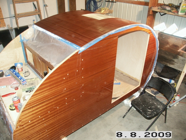

Postby Rock » Sun Oct 31, 2010 5:58 pm
The only screws in my tear hold the hardware on. I used Miller dowels through the whole thing.
The Sapele veneer was very thin and brittle and I had zero issues with chipping. I used an electric drill with one of those drill press attachments that I picked up at the junk store. Could be your speed it too slow, you're pushing too hard, or you're not coming in square.
My spacing is either 4" or 6". I am positive that these dowels (especially in Black Locust like I used) are way stronger than screws is shear, bending and tension. My tear is rock solid but is put together with epoxy too (but use wood glue on the dowels - Titebond III in my case.)
