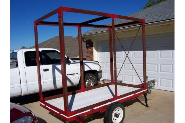

I am in the process of building my trailer and have come to the point where I will be putting up the sides. I'm not sure if I have enough to stabilize the sides so they won't buckle? I'm using 4' by 8' wood siding panels. Any advice would be greatly appreciated. Thanks.

But he's building a box which takes on a different stress factor than a round shape. And with a steel frame, I'll bet he didn't plan on cross spars. It would also be nice to know what thickness ply he plans on using. :thinking:

Looks to me that his walls are up. Just need to add plywood.
What do you think, maybe some diagonal braces in the rear like has been done up front? :thinking:

YEP; she is all steel. 4" "C" purlins corners and 2" x3" base angle for top and bottom framing and center and soon to be windows sill supports framing supports. The rear door will be 3" "C" Purlins framed and welded hinges. The outside covering is 1/2" exterior wood siding and will have insulated walls and door. The floor was my floor in my trailer ( 3/4" exterior plywood re-sealed ). Good job welding her up Charlie. Believe me it is strong ...... you could remove the HF frame and place axle and tongue on the frame alone and the trailer would be plenty strong as is. :applause: ;)

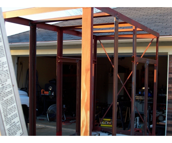

Oh yes .....there will be two more steel spars between the ones on the roof section and ones below the windows between the steel frame that you see in the picture. The rear door will have a strap cross bracing like the front. The windows are not framed yet in the picture and the rear door is not made but 3" "C" purlin steel is cut to weld up. Oh yes a different type of door seal is in the making .... you will have to wait for the pictures :D :twisted: 8)

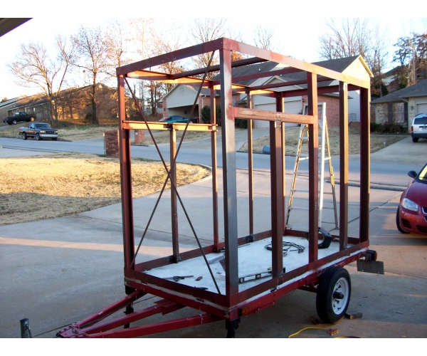

Looks like he is getting closer to getting sides on.....framed for the windows.
He has the door frame in pieces and hinges and closure hardware ....... just waiting to get skinned with + 1/2" outdoor siding.
