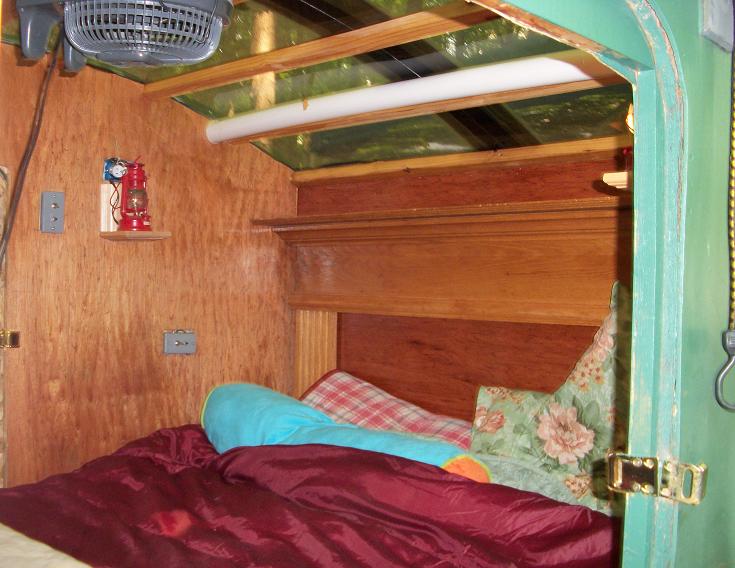

One quick hint the heat will stratify at the roof. add a ceiling fan and push the air upward and wash the heat back down the walls to where you sleep for greater comfort.
OK OK not a paddle fan just a decent sized small air circulation fan. Here is the one I use.
Yep it's a see thru roof not much " R" value there ;)
