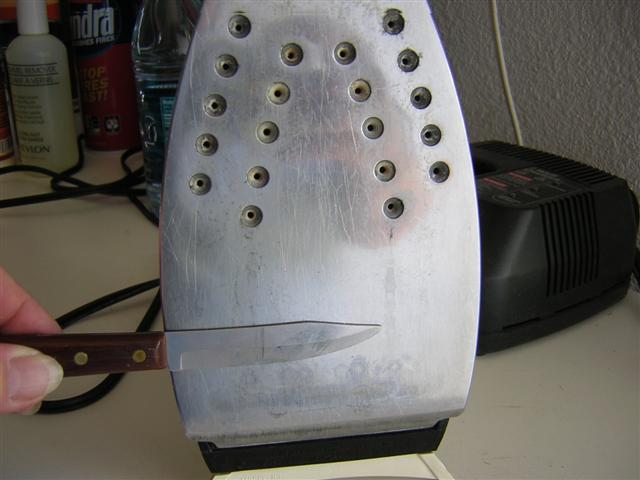

Postby S. Heisley » Sat Nov 06, 2010 9:54 pm
It takes patience, but this works, 'on the cheap':
You have to re-heat the knife for about 30 seconds after each 7 foot cut or after each full small piece is cut out, though.

Postby Miriam C. » Sat Nov 06, 2010 10:21 pm
S. Heisley wrote:It takes patience, but this works, 'on the cheap':
:thumbsup: :applause: Good idea!

Postby tuber » Tue Nov 09, 2010 3:39 pm
Great idea!!!
