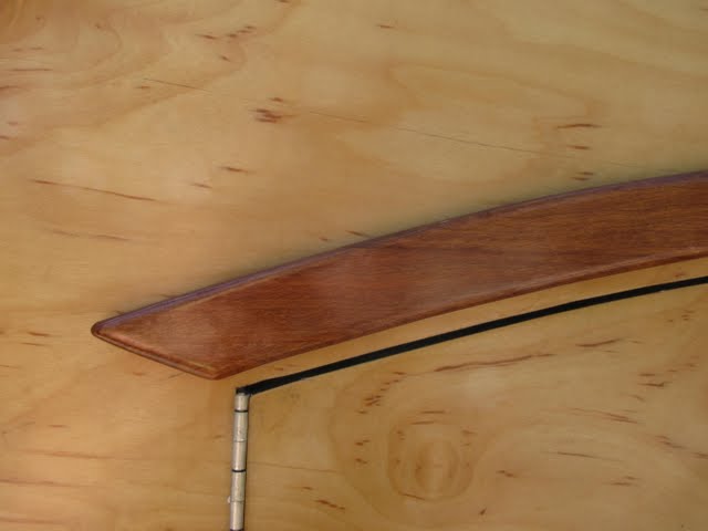

Thanks Wolfgang. Great looking camper. I plan on covering the perimiter trim with the aluminum as you suggested, more concerned wiht the trip around windows, the door and along the bottom. In looking at your album, I am impressed with the trim piece over the door, that is a piece of work!. Did you just use epoxy to attach and seal that in place? If so, what epoxy did you use? Do you have a recommended spar varnish?

Postby Wolfgang92025 » Wed Nov 10, 2010 9:35 pm
Buck06,
Thanks for the compliment.
I used a band saw with an angle table to get the rough shape and a hand plane to get a nice smooth finish. Epoxy is System3 and I used Minwax spar varnish. Trailer has only been out on 4 trips so far and stays in the garage the rest of the time. No problems so far. I used it because I wanted to warm color look. Took quite a few coats. I think depending on what exact look you are after, their might be easier finishes around.
