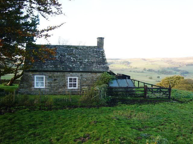

OK, look, I apologise in advance for steering this thread waaay off topic but this comment made me think of a lovely house I surveyed last year. Minimum 500 years old and maybe more, with stone floor, stone walls and a proper stone roof about 1" thick - none of yer lightweight modern stuff here:

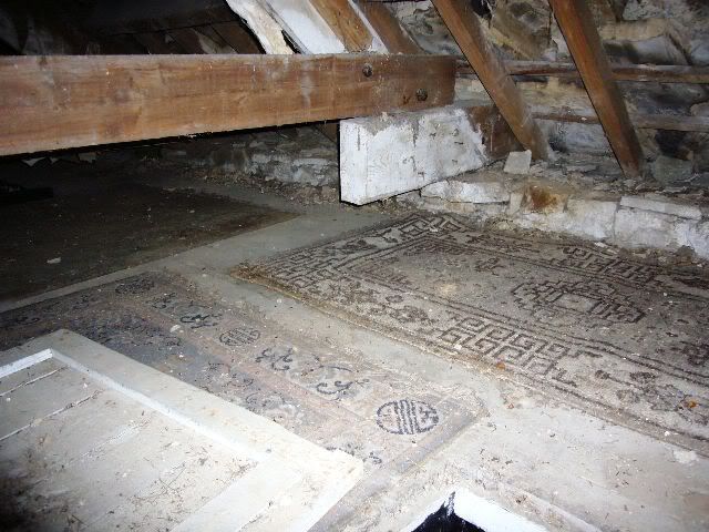

And to please Len, here is the only insulation anywhere in the property, laid on the loft floor:
Some actually had been rather nice rugs, though all were worn thin in places.
