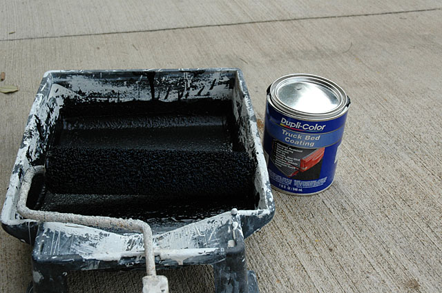

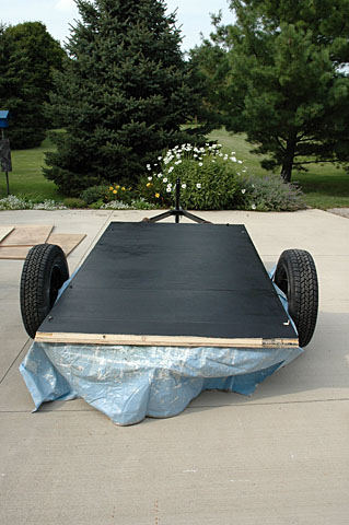

Postby Michael W » Sat Jul 16, 2005 7:31 am
We used Dupli-Color brand truck bed coating. I rolled it on we a textured paint roll, it gave a very nice looking, durable, waterproof finish.
