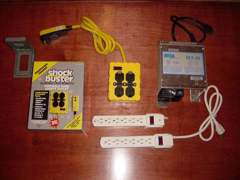

I am also using a converter. I plan on using it without a battery for most of the time. When I go on a primitive camping trip I will add a battery to the system. I think it is a great way to go.

ImageImage Image
