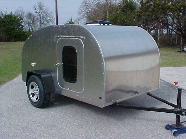

Postby SteveH » Sun Jul 10, 2005 10:43 am
I covered the side of my tear with the aluminum only. The body is all on top of the frame. It achieved the "look" that I was after.
