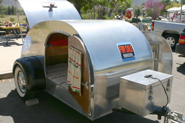

I have F65 15 ST tires on one of my Kit Tears. Im wondering if there are whitewall tires available in this size. Id love to purchase some real wide whites for it if possible.
Does this tire size translate to 205 65 15 by chance into metric
They need to be replaced but I cant seem to locate any in this size.
Dont know whose Kit this is but its a nice one. These tires appeal to me greatly. Its the type Id like to get.
