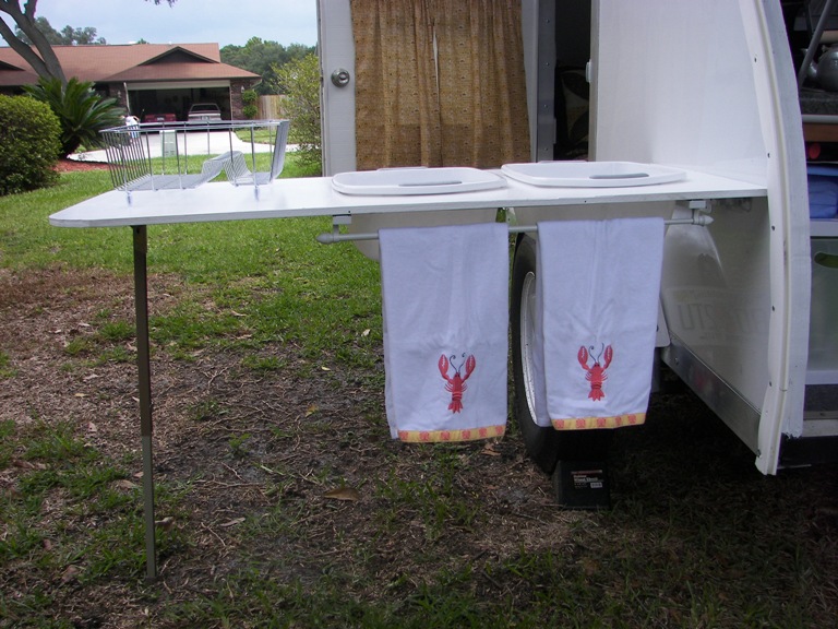

driftwood wrote:Buying a used 06 Little Guy 6 wide. Dont like the galley setup, would like to add sink, stove, and cabinets. Not sure what to do with the goofy space between the counter and the back either. Looking for suggestions on how to make a nice galley in this unit. Also suggestions on upgrading interior as well- thanks.
I have posted this several times but see this is your 1 st post so here is a blast from the past.
This is Becca's sideboard design. I intend to take this just a little farther and have the wash and rinse tubs slide in from underneath and save the cut outs to be replaced in the openings to make a cooking station and then you simply lift out the inserts and you have your clean up station. This saves the galley area for the all important storage.
