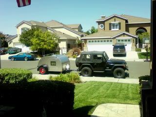

Postby dano » Wed Dec 22, 2010 7:39 pm
I thought about an over the fender type. I would like to some day do a Widget with the HF frame like in the Design Library.
That mini Shasta sure looks good. Ive always liked it when I was a lurker.
This is what I have now and its a 5 wide or just a little under. Enough to enjoy a double bed, 8' long.
Thanks
