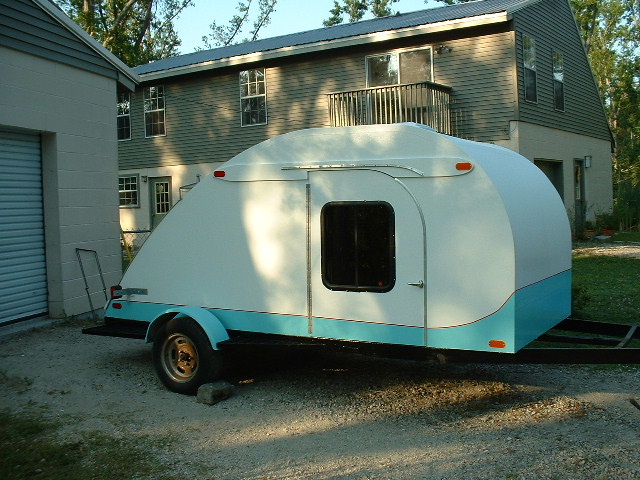

Having built a 6X12 TD 5'tall right off the bat , I found the inside very roomy , but the outside was pretty tall sitting on the old boat trailer I used ..giving it a rather large profile ... and making it taller than my truck ... :o
I could have easily lost 6-10" of height and still been comfy ... This is assuming a well padded floor for the old bones to crawl across... Image
