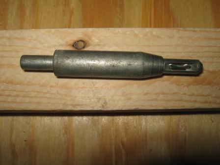

http://tnttt.com/album_ ... c_id=74932 hello all i was reading the thread with everybody talking about what tools they use thought i would throw this one in its called a vix bit it locates on the hole in your hinge and has a little drill bit that comes out of the center of it when you push, for perfect centered holes every time and a time saver,,the one in the pic is 3" long with a 1/4 shank :thumbsup:

Thanks, that looks like a very useful gaget

I've got a couple of those. They do come in handy when centering a hole.
