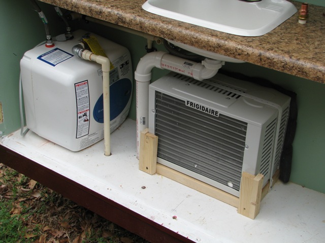

Postby Nosty » Sun Mar 27, 2011 9:24 pm
I guess I'm the devil, too. If the campground has water and electricity, I'm there.
I just installed a 4 gallon Ariston hot water heater in my TTT. It's 120VAC but the hot water is instantaneous. I ran it for five minutes in the sink without any loss of heat. I'm installing a shower head in line with it and a removable shower curtain across the top of the back doors for those more than overnight trips. I'm converting an old plastic freight pallet with a drain for a shower floor that'll slide up under the TTT when not in use and it will drain to the camper drain while I'm showering. Who ever said camping had to be uncivilized? If these consistent weekend rain deluges would ever stop, I could get it finished and get the cabinet faces and doors in.
Eventually I'll get a generator for those few weekends where electricity isn't available, but I usually camp at places with water and electricity.
The unit cost $180 and I got it at Lowes: http://www.lowes.com/webapp/wcs/stores/ ... er%20GL4.0
Just another option should you be interested. Good luck.
