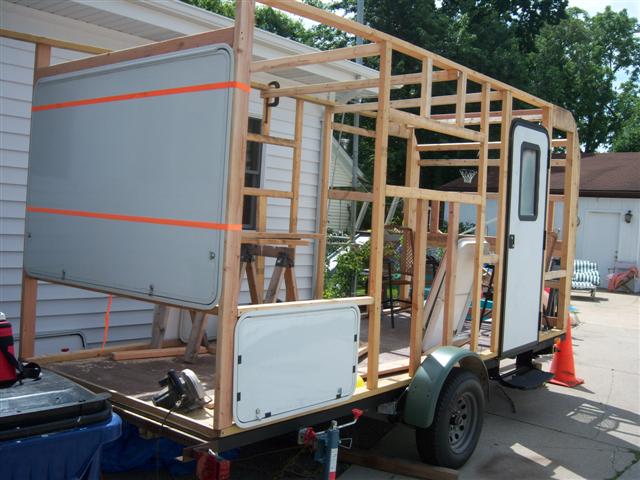

I am currently working on another chassis and thinking about what I might be able to build on it. I like the classic looks of the rounded ends but not being a wood worker I am intimadated by building a round hatch that will seal everything out and cutting out the side itself. With the Squared design you have more interior space and easier to build. I have a large salvage hatch from Bontrangers to use. I have read many posts over the years on here and am still torn on which way to go. I actually may be able to find the time to get this thing built. I have tons of stuff to build with stored in my garage, I just need to get modivated and make the time to get it done. Any thoughts from the crowd? I was modivated to get out in the 25 degree weather this morning for a couple of hours to move it forward. Work gets in the way of working on it. I only camp 3 seasons for the most part so I am only thinking of insulation in the roof, Use 3/4 inch ply and rough saw oak that I have salvaged from large crates and then just stain and polyurathane the interior. I would love the hit it hard and make the Indiana event in July. Bill

Postby bobhenry » Wed Jan 26, 2011 3:14 pm
Is this the one you are working on ????
or have you started another ?????

That is the standee that is stored in a barn for the winter. Oh no, I have another frame that is 6 x 12 and have enough junque that I have started a 2nd build before the 1st one is done!! Cannot find my camera of I would have a couple of pictures in the album. It is just a chassis now. I ran conduit and gas line on Tuesday and welded square tubing on the corners for accessories, Now I have to wire lights and the brakes, bolt down the floor and I will have another platform to build on. I want to build something that I can lower the tongue to the ground and roll into my garage to store and work on it. Most of the camping I do is just myself or my son and I going to car shows and steam shows. I was hoping to put this one together to use this summer while I whittle away at the standee so my wife can go along.

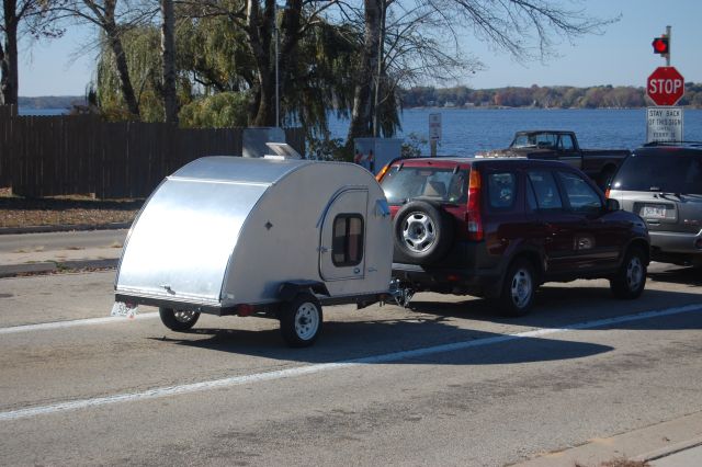

I was scared to death of the curves....But I loved the look of the classic tear so much I decided to give it a try. I was biten last year and spend many cold nights working in the garage. It was worth it. Had a wonderful summer and fall of camping last year and the tear made good camping trips GREAT!
