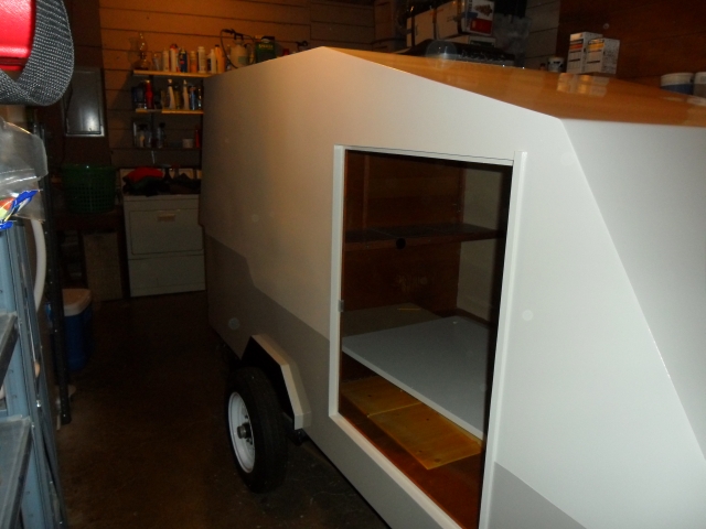

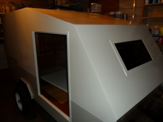

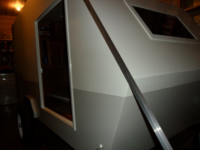

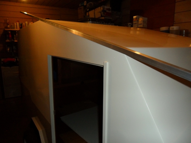

I finished up the exterior paint job (except for the trim color and logo) and I'm happy with it (two coats of marine epoxy, then 2 coats of oil based primer, and 2 top coats of Valspar oil base deck and floor paint). So now I'm wanting to put some aluminum trim on it, but I reaallly don't like the idea of putting screw holes in the edges of a nice, completely sealed finish.
Since my hopper is angular, I was planning on using 3/4 alum angle 1/16". Wouldn't some sort of poly ureathane adhesive do the job? I've seen 3M 4200 sold locally but I haven't used it. I searched the forum and read about Sikaflex, but can't find that locally. Are there any other brands of adhesives used for such an application? Maybe even some kind of tape?
I considered no trim at all, but since my hatch will need aluminum trim (becuz of the way I designed it :duh: ) I thought the rest of the trailer might look kinda funny without it. Sorry I don't have any pics of the hatch yet (it's not fully assembled...you can see it lying inside the trailer in the second picture).

I've been trying to think how you can use it on angle as you can't slide it into place. I think you can stick the tape to both faces of the body, push the angle into position and then pull out the release tapes to make the final bond.
