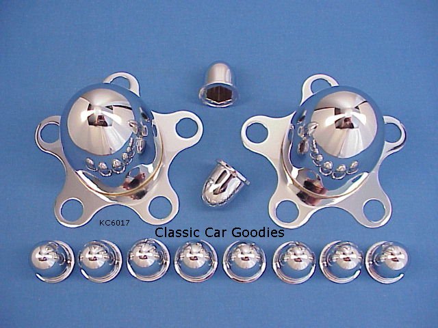

You meant this kind correct? ;)

Heikki...where did you find the Spider hubs that you have in pic 1 on your album? Yup, those ones...The ones I found were pretty high dollar! On yours...those wheels appear to be a smoothie cap, as opposed to a baby moon. Baby moons go over, smoothies fit inside. Are the dimples for the cap on the inside of the hub dished area or on the outside? Doug
Postby Classic Finn » Sun Jan 30, 2011 10:13 am
doug hodder wrote:Heikki...where did you find the Spider hubs that you have in pic 1 on your album? Yup, those ones...The ones I found were pretty high dollar! On yours...those wheels appear to be a smoothie cap, as opposed to a baby moon. Baby moons go over, smoothies fit inside. Are the dimples for the cap on the inside of the hub dished area or on the outside? Doug
Hello Doug. A pleasure to hear from you. :) Spider hubs I found here:
http://www.classiccargoodies.com/catalo ... 3/Hub_Caps
Scroll down almost to the bottom you,ll see them.
Umm :oops: let me check on them dimples Im not sure.
Doug on the front of the Kit there was a spare tire holder which was removed due to too much towbar weight and here they are very strict with it. Well when I removed the entire wheel off I presume its as you say a Smoothie Hub on the spare which fits perfectly. As on our tear. It will fit on ALL wheels when off the axle.
When mounted the hub center pertrudes out about 3 inches and then of course they dont fit at all. It came with 2 Bullet type hubcaps which are not chrome but some sort of plastic or rather light metal since rust has completely rotted them.
What if I can polish up the grease cover to a high polish shine and get some nice chrome lug nuts for it???? :thinking: This would make it look better than it does now.. I know Im Finnicky. :lol: Or are there other wheels that would do the trick automatically? With the same pattern? Could this be a deep dish or reversible type wheel? Im not sure or no expert thats why Im asking. And I know Doug you are the Wizard in problem solving and coming up with great ideas near and far.. :thumbsup:

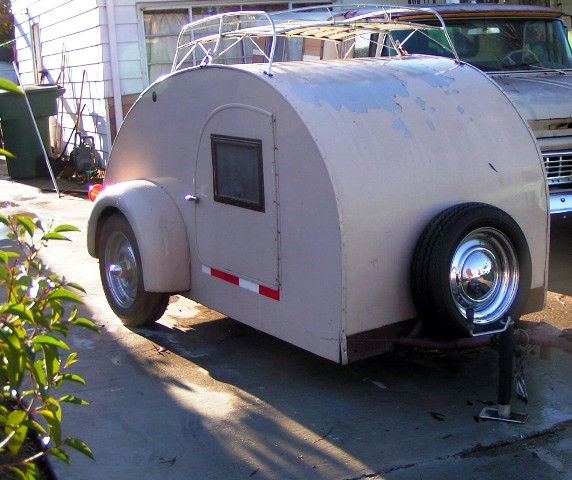

Postby Classic Finn » Sun Jan 30, 2011 5:41 pm
Here you can see what Im talking about. God I wish the hub could fit onto the main axle as nicely. Id love that.
Also if anyone has any pics of this tear at any gatherings Id sure love to see them. :worship:
