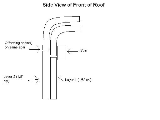

I hope the above makes sense as it was crudely drawn, not to scale, and probably labeled poorly, but here goes with the question. That is a side view, as I see it in my head today of the front of the roof.
If I go with plywood, 1/8" thickness, I've read here that you want to double it up. Being from MO, with summer hailstorms a yearly occurence, I assume it is for strength in those situations. My tear will be 6' wide, making seams inevitable. I am thinking of using 4 x 8 ply, flipped longways, and running a spar under each seam, as I've read that is the proper method.
If I double up the ply, I should probably offset the seams a little right? What should I use to fill each seam (inner and outer)? Bondo seams :lol: to be a popular product here. If I sand the bondo that will likely get on the face of the ply, the wood will still take stain, right? Last question, should I mess with treating the inner layer of ply (with stain, varnish, cpes, etc.)?
Thank you for getting through this long post, any replies are greatly appreciated.

I can try to explain what I did on mine.
I cut my first layer of ply one spar short
so they would not overlap on a spar.
The first layer is just stapled and glued.
The second layer I taped fiberglass over the joint.
And smoothed off with bondo.
Hope this helps.

Postby Woodbutcher » Wed Feb 09, 2011 2:00 pm
I offset my seams on different spars, not the same one. I think your asking for trouble if you only stagger the seam a 1/2" or so. I would glue and staple down layer one. Then since you want to stain the outer layer you will have to glue and strap the second layer to keep it free of seeing fasteners. If you are doing a Woody style then you may consider covering the seam with a trim board allowing you to seal the seam real well under it. Bondo or wood filler is not going to stain, try to not use it where it will show.

Postby DudKC » Wed Feb 09, 2011 2:17 pm
Thanks for the replies guys. So I should alternate the spars that the seams are tied to, and by making say a 3" strap of 1/8" ply, and gluing it on the inside of the seam of the 2nd layer, I can avoid using a trim piece? I would think there would still be a need to fill the seam with some kind of filler...am I wrong about that? Would a dark enough stain hide a small line of wood filler?

Postby rbeemer » Wed Feb 09, 2011 2:56 pm
I think you are trying have the seams match up between the layers and that is not what you want.
If you put on the first layer from front to back you should put the second layer on from back to front this way your seams on the previous layer are fully covered by the top layer. It is the same principle for putting on roofing shingles on your house(you do not line up the edges of your shingle from one row to the next they are staggered)
Hope this makes sense

Postby Miriam C. » Wed Feb 09, 2011 3:02 pm
I treated every piece of wood I could get to! You do want to stagger your seams. If you want to stain you will want to use trim over the seam or get them really close and fiberglass. I did 1/8" for MO storms. If it gets a hole I will put on another layer and fiberglass over it! 8)

Postby aggie79 » Wed Feb 09, 2011 4:01 pm
Welcome DudKC,
If you insulate your roof and have your spars at around 12 inches on center, 1/8" plywood is really all you need, particularly if you epoxy the plywood and/or cover it with aluminum or other roof material.
I used a single layer only of 1/8" plywood, and it has supported my 200 pounds several time during construction (prior to the installation of the aluminum.) If you do go with a double layer, and your spars are 12" on center, rip the first sheet of the first layer down to 2 feet in width and then apply the other sheets the full 4 foot width. For the second layer, start with a full 4 foot width. This way your seams, other than your start and ending points, are staggered apart 2 feet.

Postby DudKC » Wed Feb 09, 2011 4:45 pm
If builders the quality of Miriam and Tom say 1 layer of 1/8" is good enough (w/ insulation) I will definitely consider it. How does the fiberglass in the seams work? I've never worked with it before, would I still strap the backside and do the fiberglass over the strap?
