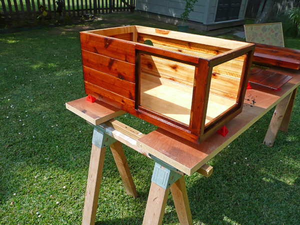

aggie79 wrote:I'm building a tongue box out of Home Depot t&g cedar. The picture below is how it looks with 2 coats of Raka epoxy and two coats of Emtech 9300 - a UV resistant, varnish-like finish.
It looked just as shiny before the Emtech 9300 with just the epoxy.
Deryk the Pirate wrote:Ah, ok then that makes sense as to the multiple coats... I understand the several coats on the ends because it will soak in up the wood's tube/cell's.
Yeah good point about doin as much on sawhorses and tables while its flat and easy to brush. I have epoxy at my storage spot but the CPES I know kinda sinks into the wood. With the Raka does it leave a shiny finish with 3 coats? I did plan on painting my trailer for a final finish.
