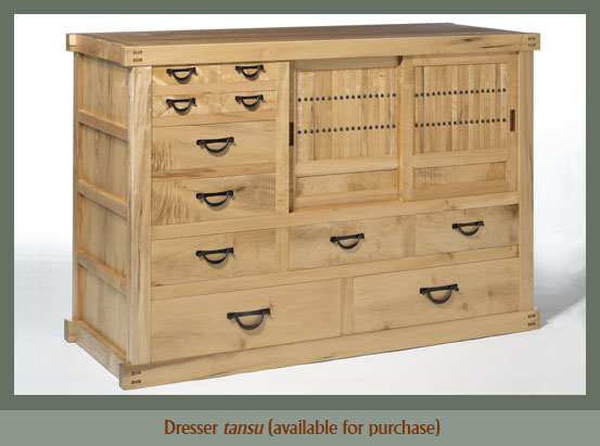

A guy around here grows the stuff. I don't know where your info comes from but I assure you the paulownia he grows is no cedar--it has great big heart-shaped deciduous leaves. I don't know the rot resistance of it. I do know from talking to the grower (and from driving by his plantation) that it is indeed fast growing. He also told me that, traditionally, in Japan a tree is planted at the birth of a daughter and the wood is harvested to make traditional tansu furniture for her wedding. It is certainly beautiful wood. The grain reminds me of ash with giganticly thick growth rings and a dark tan/light brown color.
