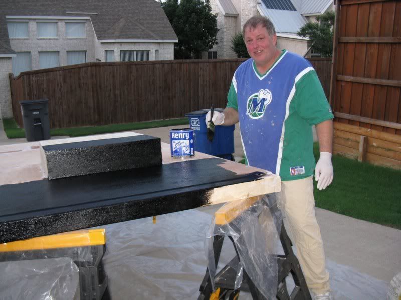

Postby planovet » Sat Mar 12, 2011 11:25 am
ImageMark (& Cindi)

If you decide to go with the Henry's brand, make sure its the 201. I recall a member on here getting a can of different number than the 201, and it remained tacky for a long time (a week or 2)
Many people used and like the Henrys 201 that planovet used.

Postby planovet » Sat Mar 12, 2011 12:10 pm
One gallon is plenty. My trailer is 5x10 and I had plenty left over. I used only one thick coat and it only took about 48 hours to dry. It's been 2 years now and it still looks like the day I laid it down.
Make sure you use gloves and old clothes. That stuff will get everywhere. :lol:
