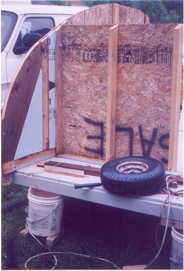

Here is my red neck stabilizers................
O.K. just kidding but I was tired of setting in the galley or stepping up and getting dumped on my butt.
Now use the little aluminum screw type stands.
