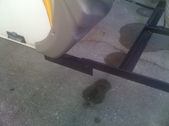

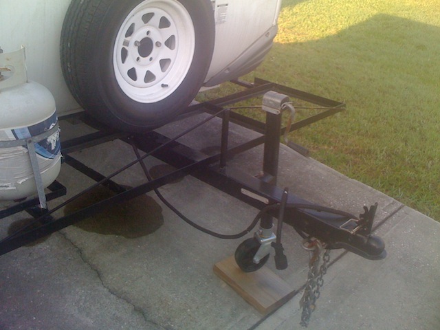

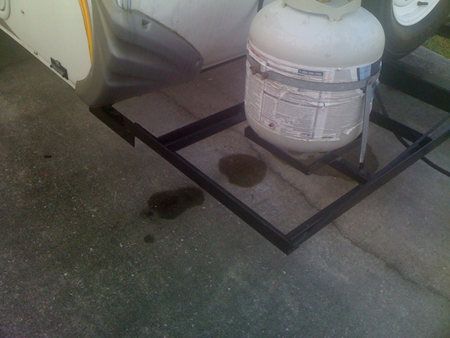

Hello Bill This is what I did with my TTT;
I found a local welder and asked him to build this enclosure, now I can put a tongue box and other accessories in my trailers tongue without issue. The cost was about $120.00.
