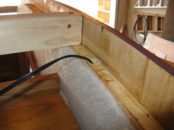

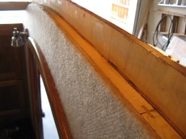

Postby planovet » Tue Jun 07, 2011 2:50 pm
I made my exterior sides, then the interior framework and then glued the interior sides to the framework. I used a router to clean up the edges.
I made a "ledge" to put my spars on so I did not have to worry about cutting slots.

Postby TwilightLane » Fri Jun 10, 2011 10:58 am
What GPW said: I built & assembled my walls: exterior, then insulation, then interior 5mm ply in one complete sandwich. Only then did I attach to the trailer. I think you might be making your assembly more difficult than it need be to do it all in-place on the trailer.
Also, like planovet, I made a ledge at the top of the wall. I used that ledge to drape the internal ceiling ply. Only then did I add the spars - they were one of the last things I added. I had some shelving and cabinetry to help hold walls vertical.

Postby planovet » Fri Jun 10, 2011 12:00 pm
TwilightLane wrote:Also, like planovet, I made a ledge at the top of the wall. I used that ledge to drape the internal ceiling ply. Only then did I add the spars - they were one of the last things I added.
Same here. The spar in the picture was just a temporary one. Resting the ceiling ply on the ledge and then putting in the spars was very easy. :thumbsup:
