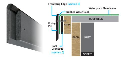

interesting, how would you keep teh rubber membrane from peeling off teh edge while running down the road?

Postby bobhenry » Thu Apr 14, 2011 12:53 pm
Your buddy being in the biz will explain but the membrane is captured between an inner and and outer metal or hard rubber trim edge. I found a pic of the hard rubber style...........
