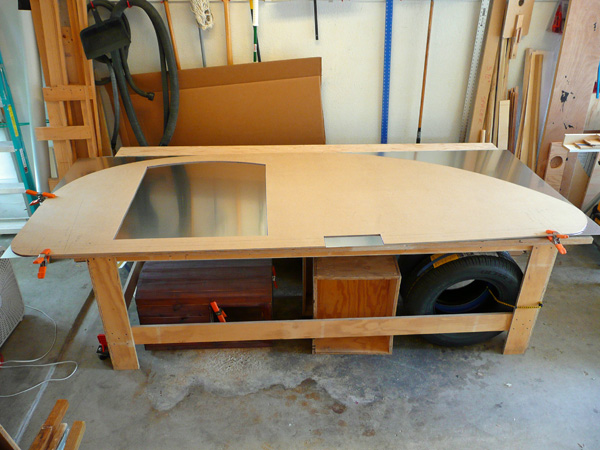

Early in my build, I made a template from 1/4" mdf to use to layout the sidewalls. When I was ready to cut the sidewall aluminum, I used the template to draw an outline on the back side of the aluminum. (The front side had a protective plastic sheet.)
I then cut the aluminum with a jig saw. The cut line was about 1/4" inside of the template. The "gap" is to allow room for the aluminum to expand and contract some.
With the temperature extremes in Texas, I decided to "float" the aluminum. I did use 3M 4200 around the perimeter to help seal any moisture from seeping underneath the aluminum.
The aluminum was then applied and, like Madjack, I used a few staples to secure it into place, along with blue tape and clamps at the openings.
In this picture, you can see the gap between sheets, the staples holding the aluminum, and squeeze-out from the 3M 4200.
For the smaller openings, like for the vent fan, electrical inlet, etc., I didn't cut those before installing the aluminum. I came back later and made the cuts using a router and a solid carbide "knob" bit.
I do have some oil-canning in the sheets when the temperatures get over 85-degrees, but it isn't that much. So far everything seems to be holding together.
