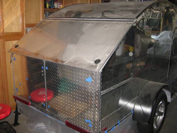

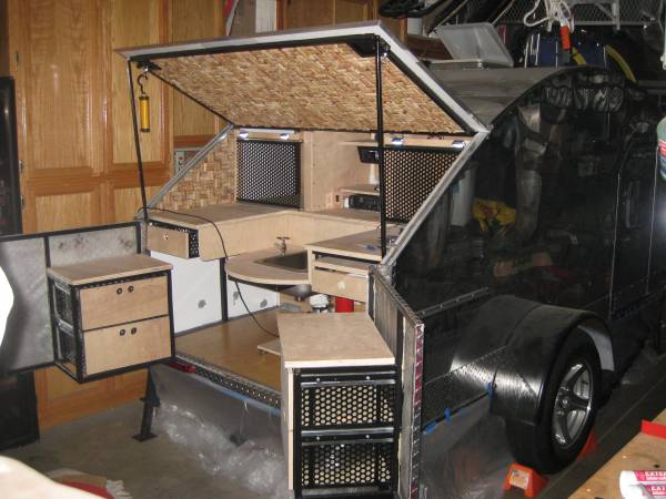

I did something like that. Still a work in progress...
The guy I bought the trailer from had 3/4" plywood screwed to the Al diamond plate doors. This would be fine if you did not want to support any weight on the barn doors.
