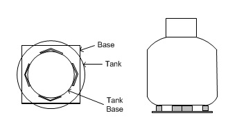

Any other good ideas for a home-built propane tank mount? I am planning to use a sheet metal base with pieces welded on to surround the base of the tank so it won't move laterally. What I'm still trying to settle on is how to hold down the tank on the base so it won't come out of the pieces that keep it from moving around on the base. I've also seen a mount made with metal strapping and am considering that as well.
This is just about the final piece to build for the PT and I'm open to ideas for the hold-down parts and pieces. This is my drawing of the tank on the metal base with four pieces welded to the base to surround the base of the tank.

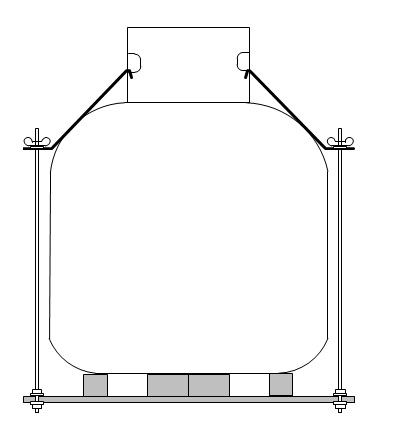

Here's what I did!
Postby cracker39 » Sat May 14, 2011 12:04 pm
Mike, that's about as simple as you can get and I think it would work for me. I presume that you heated and bent the threaded rod to hook onto the top of the tank. I'm thinking that I might use your ida.
The photo I saw had four of the strong rubber bungee straps with hooks on either end. They hooked onto the base and up to the top of the tank like your rods do. I too am just not sure about using them. Securing the tank with metal hold downs seems more secure.

Mike, your rig looks like you have to access the nuts to loosen the holddown from beneath the mount. Here's my idea. Attach two pieces of threaded rod to opposite corners of the base with nuts and lock washers on both sides of the base so the rod is permanently attached. Make two holddown brackets from the same metal that I'm using for the base, each about an inch wide. the "hook" goes over a lip of the tank and a hole in the outter end of the bracket goes over the end of the rod and is secured with a washer and wingnut. Only the two brackets come off leaving the rods attached to the base and the tank is lifted out for refilling

Postby cracker39 » Sun May 15, 2011 4:50 pm
thanks to the suggestions, I fabricated my tank mount yesterday, coated it with rustbullet and assemmbled it today. It's hard to see, but in the bottom right photo there is a washer and wingnut on the top end of the rod holding the end of the clamp down. The tank is one I've had for years and it is the old style. I'm hoping I can trade it back to Blue Rino for a full tank of the new kind. But, the tank is nearly full now and I've been filling 1# bottles from it.
