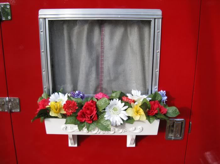

I use only the sides, and they make a plastic half tube that fits into the grooves to hide the screws.
93079

Postby Alfred » Fri May 20, 2011 6:42 pm
Hey Gang,
Front window is in - Now I'm working on the side windows.
AL :thumbsup:
