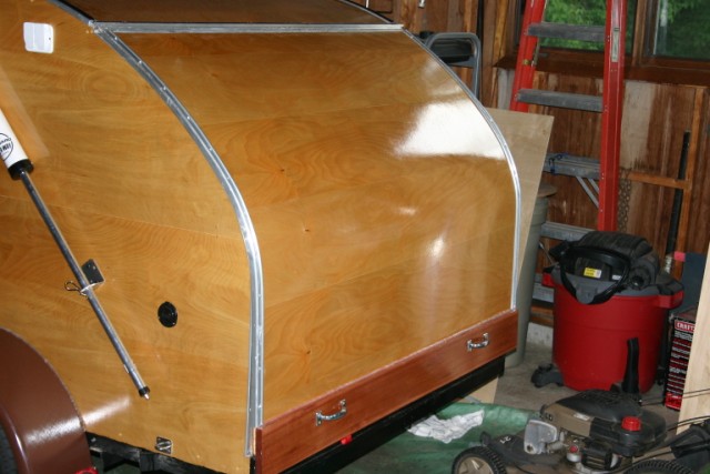

I used a 1x6" piece of wood, screwed to the bottom edge of the hatch. It hangs down to cover that gap and has a piece of weatherstipping to make it water tight. It also gives me a nice stiff structure to attach my hatch lift handles to. It doesn't look half bad either.

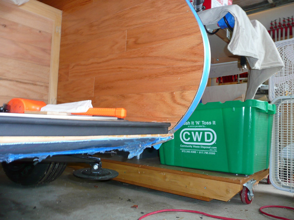

I used a "P" shaped self-adhesive weatherstripping from McMaster-Carr. As I recall it was either 1-1/4" or 1-1/2" wide.
For looks, I added an aluminum strap on the flat part.
