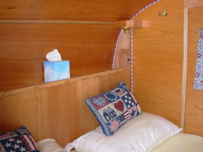

Postby Nobody » Sun Jun 05, 2011 6:38 pm
7/16" Stars'n Stripes rope installed with industrial strength Hot Melt glue went on easily, covered a multitude of errors, & matched pretty well our curtains, throw pillows, galley trim, & exterior decal theme -
We've since redone the galley but kept the red, white, 'n blue colors -
Harvey -

Postby Nobody » Mon Jun 06, 2011 8:13 am
glenpinpat wrote:I do like the rope where do you purchase coloured rope?
Found the 'stars'n stripes' I used at Tractor Supply. I've seen quite a lot of different colors/patterns at Wal Mart or even the Dollar Store.
