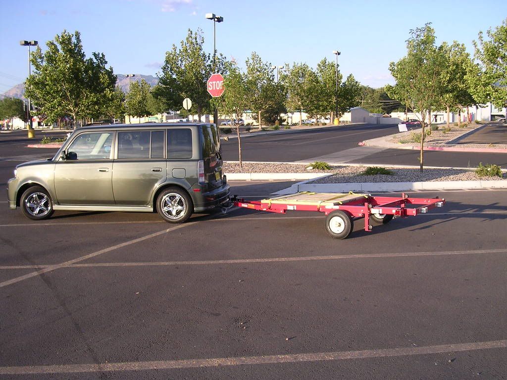

I'm gathering parts to build a Woodie similar to Lens:
http://pg.photos.yahoo.com/ph/len19070/detail?.dir=ea49&.dnm=64c7.jpg&.src=ph
and need some direction on how to proceed next. So far I've gotten the fenders and a HF trailer and got it put together...
(click for larger pics)
I've never done any jointing in wood so I'm going to have a rather steep learning curve. I plan on sandwiching 1/4" Luan or dark Birch plywood between the outside wood strips and the inside support structure and insulation. Mainly I need to learn an easy way to make the outside pieces so they conform to the outside shape of the TD.
I bought a router and belt sander today, so I'm getting closer. Are those Harbor Freight biscuit-jointers any good?
Any and all suggestions and advice will be greatly appreciated.
