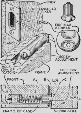

Postby bobhenry » Fri Jun 17, 2011 11:47 am
Here is another positive closed one......
http://www.rockler.com/product.cfm?page=21480&filter=DRAWER%20SLIDE%20STOPS
Why couldn't a button type friction catch be added between the side rail of the drawer and the cabinet face.
Postby dh » Fri Jun 17, 2011 11:49 am
That's a good idea, I'll have to try them out this weekend. :thumbsup:

Postby bobhenry » Fri Jun 17, 2011 11:56 am
Bore the spring loaded button in the rail and install 2 catches on the drawer box. One to lock in and one to lock out into the extended position.

Postby dh » Fri Jun 17, 2011 12:06 pm
I like that idea Bob, I might be able to make that work. Now where do I get those catches?
bobhenry wrote:Bore the spring loaded catch in the rail and install 2 catches on the drawer box. One to lock in and one to lock out into the extended position.

Postby bobhenry » Fri Jun 17, 2011 12:16 pm
That was out of Rockler (I think) but any good builders hardware center should have them. Print off the picture and take it with you in case the clearasil crowd is on duty and don't have a clue. :roll: They are use a lot on small linen and pantry doors. You might find smaller versions of them on some salvage medicine cabinet doors as well.
