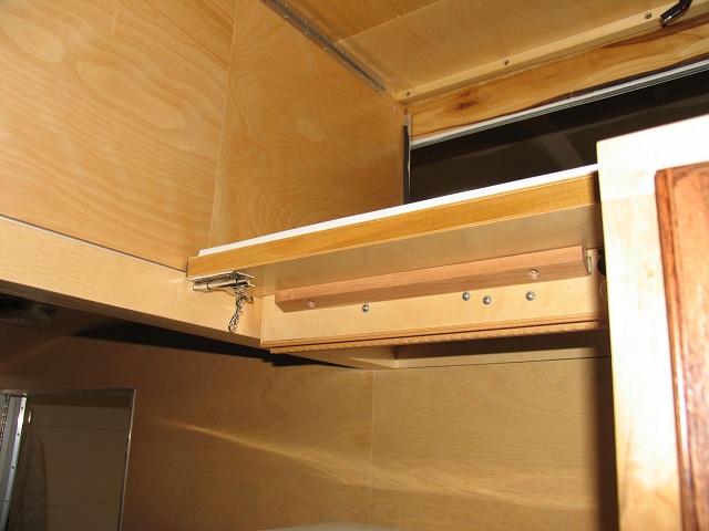

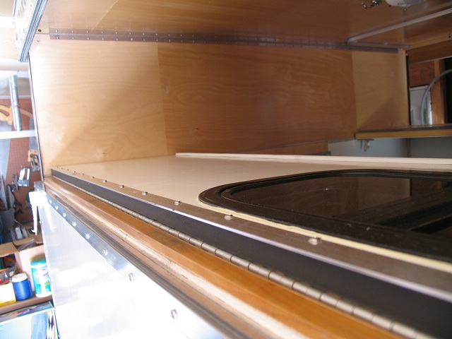

Postby bdosborn » Sat Jun 18, 2011 3:42 pm
Here's mine:
