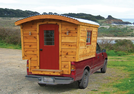

Postby bobhenry » Fri Jul 08, 2011 8:05 am
Pardon the poorly scanned picture but this little barn clocked more than 30,000 miles in the 6 years I was building mini barns.
Lay from rear to front and double the lap over of material and you will need to roll over the front sheet and trap it so the wind won't be able to lift it.

Postby Deryk the Pirate » Fri Jul 08, 2011 11:13 am
I was thinking of putting it on in the same direction as the picture since I could lay a 2nd layer on the ends to increase strength. I like tghe idea that rsin will run off it very well.

Postby aggie79 » Fri Jul 08, 2011 11:28 am
Deryk the Pirate wrote:I was thinking of putting it on in the same direction as the picture since I could lay a 2nd layer on the ends to increase strength. I like tghe idea that rsin will run off it very well.
Deryk
Deryk,
I'm betting that the curve of the roof in the picture was pre-formed. I don't think you can bend "straight" sheets of corrugated steel/aluminum against the (perpindicular to) the corrugations.
When I used to build metal buildings, we used fasteners on the "highs" of the corrugations to tie to the purlins, rather than in the "lows" or "flats". This resulted in a lot less call backs for leaking roofs.

Postby David S » Fri Jul 08, 2011 11:39 am
Deryk
Deryk,
Take care,
If you use the corrugated barn metal,not the R panels used on metal buildings.it will bend even sharper than the pic.as I said we used to build round top or some call them quansit barns,and they had a lot more curve than what your doing.Here is link to what I was talking about the foam gasket. http://www.metaldeck.com/foam/78.htm[/url]
