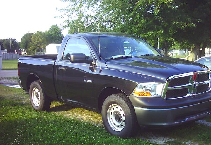

Postby bobhenry » Mon Jul 11, 2011 8:21 am
09 dodge 6 cylinder full sized pickup 17 / 21 and towing at 52-60 it drops just over / under or around 2 points depending on the head winds to 15/19
