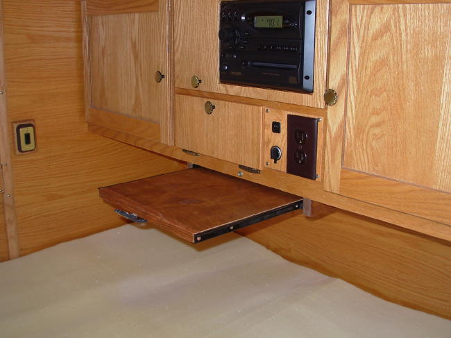

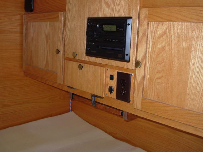

We needed a table/shelf for a spot to place a small DVD player, laptop, heat cube, etc. Didn't want to use wall space for a fold-up so I salvaged a set of 'glides' from the keyboard table of an old computer desk that was being junked. Glued & screwed a couple of 'rails' to underside of my cabinets, made a shelf from 3/4" plywood with solid wood front, & added a 'snap fastener' tab from an old folding boat seat to hold it in place while underway. Works great, is out of the way, & doesn't take up much space when not needed. Size can be whatever you need depending on size/strength of your rails & how it's fastened to the cabinets...
