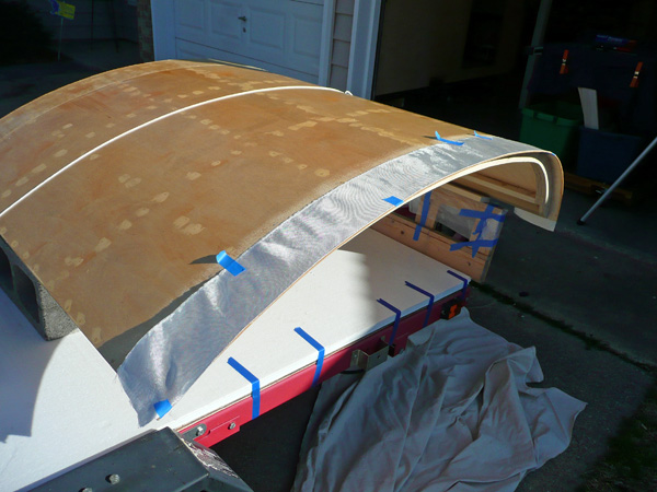

Postby ubear7 » Wed Jul 27, 2011 10:57 pm
I left about 1/4" overhang on each side of the hatch. I plan on using the insert trim on the outside and a flat "scrap" piece of the aluminum on the inside part of the 1/8" luan ply. The 1/8" luan was slightly damaged at a bottom and top corner. I wanted to strengthen this up a bit and waterproof it. Could I just use resin and brush it on both side of the luan? Or should I use some glass mat also. I have never done fiberglass but seem pretty simple especially since it doesn't have to look nice cause it will be covered. Or do you guys have a better idea?
I have a quart of the Bondo polyester resin and some Bondo glass fabric. Would this be good for this purpose? Thanks

Postby aggie79 » Thu Jul 28, 2011 8:28 am
ubear7,
I did the same as you proposed (except I used epoxy and fiberglass.)
The skin on my hatch is 1/8" ply and I was a little concerned about its strength. I can't say if it helped or not, but it made me sleep better.

Postby aggie79 » Fri Jul 29, 2011 8:26 am
DH,
I used the 6 ounce tape. It's light, but the tape plus epoxy added quite a lot of stiffness to the 1/2" plywood.

Postby aggie79 » Fri Jul 29, 2011 2:50 pm
That is one serious typo I made. I guess I need to preview my posts. My hatch skin is 1/8" ply - not 1/2". The bottom of the hatch is a 10" radius and I had to wrestle a little bit with the 1/8" to get it to curve.
